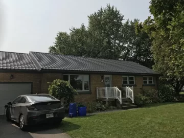

My house is a bungalow.
-Main first floor area 1100sqft
-Main floor addition probably 400 sqft but don't expect much heat to make it here since access is thru a single door off the back of house.
-basement full basement (mirror of main floor) but only half finished. (finished room is under living room where the stove will be )
-i think my furnace is 60k BTU but it's oversized. Since it cycles even on the coldest days and nights.
-main living area around the stove is my open living room and kitchen/dining area is about 500-600sqft.

Ok I see. Then can be possible that the 20 work for you. But if possible go for the 30s.
