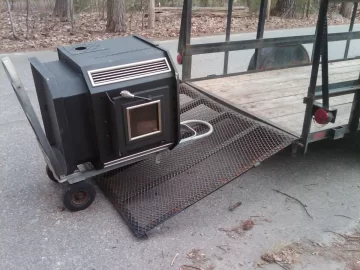

Do you have a 2 wheeler and a strap. My stove here is 375 lbs !!
  • [Hearth.com] Pellet Stove Install Advice
I actually rented an appliance dolly/hand truck to get it in the house. Problem is getting it up the stairs, my back isn't what it used to be, and the kid isn't a lot of help.
