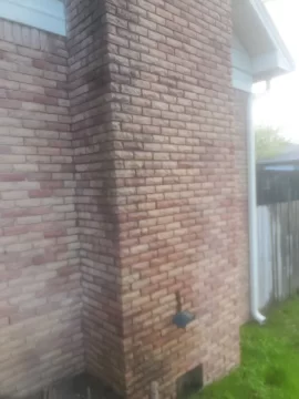

I've had a lot of water intrusion in a home I purchased that was covered up. I only noticed after starting renovation of the fireplace surround that turned into going down a rabbit hole of a rusted out firebox, separation of the surround, sagging floor, water intrusion, and crumbling mortar. I'm at a point now where I'm unsure of what to do but have a vision of getting a wood burning stove to place in the fireplace after rebuild. Does anyone have any inputs or direction of what to do? Attached are pictures for reference.

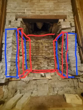

Well at this point you don't have enough masonry in the side walls to do much with that. You need to build it up to 8" this masonry if you use firebrick 10" with regular and rebuild a new face out of masonry
Or have a freestanding stove in the room with sufficient clearance to the back, and an insulated stainless liner in the chimney?

Possible to support the lintel rebuild one side at a time [blue] and line with regular brick [red] should give about 13" and provide sbout a 30" wide opening for the freestanding stove? After subfloor in front is repaired from water damage I can extend the hearth as required and than finish the surround. -- unless you have a better suggestion - stove i had my eye on is Green Mountain 40 - the lintel looks like it needs replacing as well [rusted out and way too flexible on the right side facing

A very ambitious project indeed! From all appearances, that chimney looks structurally unsound at this point in time. A lot of missing mortar even on the outside of the chimney. I'm not saying it can't be done, but this is labor intensive. I guess it all depends on your skill level but I would still want an inspection for structural soundness. If that inspection was okay, running an insulated liner up the chimney and being certain your clearance to combustibles was by the book --anything is possible. Good luck

Ok no you cannot rebuild the blue sections they are supporting your entire chimney. And there is absolutely no reason to do it anyway. The hearth extension should be done. Properly now buy removing subfloor and all framing, forming up with non-combustible forms, then pouring a slab that is anchored back to the main hearth slab.
You also should really consider an insert if the goal is to place the stove inside the firebox. Inserts are built to get heat out of that firebox stoves are not.
