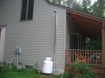

I just had my stove installed this week. When the installer was working the termination (last piece of pipe) he left it uncovered. I questioned him about animals (birds, squirrels, bees, etc.) making this their new home. He said in the 12 years he's been installing stoves he's never heard of any animals inhabiting the stovepipe. He explained that with the soot buildup it is not a welcome mat to animals.
I am now questioning this advice and wanted the input my practical professionals. Please don't blast me too much. I can still have it amended, fixed, changed or repaired.
FYI, the pipe is 12' high on the outside. It's 10' above the regulator on the gas tank. The mfg specs say to leave 6'. We went 75% more than their requirements.
TIA,
Russ

you have to reference you installation manual as to what is required A termination cap may be required or a down turned elbow may be allowed.
There is language in code about inset and vermite prevention I just don't know at this time tht is applies to pellet stoves I would require an insect screen if you are concerned
Be carfull here screens to create risistance friction and could effect how your system opperates Screens can get plugged up. Your installer may not be wrong But I guess he never got stung by hornets nesting inside the vent
The Simpson Pellet vent we used to use had a really ugly hood type termination cap. The new Simpson Pellet Pro has a cap that ends up looking similar to wwhat you have except the end is a little larger and it has a screen on it
looking at the picture and seeing where you are terminated , and that you have siding, if it were me i would have carried the pipe another few ft to clear the roof by a foot and capped with a vert. termination cap. would prevent exhaust being blown against the siding if windy and possibly discoloring it.
P.S. i have talked to people who have had birds in their exhaust blower before, as well as bees hornets dirt daubers and the like , i cannot believe that this guy has 12 years and not heard of it.

Thanks for all the replies. First, it is a pellet stove, not gas. Coincidence that the LP tank was in the exact location that the pipe exits the foundation. There was no place to move the LP tank to. I had the gas company here to evaluate it. There are windows, air conditioners or electric service panels that prevented it from being moved to another location.
Second, the termination, if not clear in the picture is coming away from the siding with a 90 into a 45. I think I agree with the suggestion about it going above the roof line to prevent any discoloration on the siding. Although the mfg directions don't address this issue.
Third, the installer did follow all the code and the mfg recommendations, the infestation concerns were just my observation. He specifically said that termination caps would impede the air flow and eventually clog, causing much worse problems than unwanted critters. His comment about not getting animals, including insects, in the pipe was based on the buildup of soot and creosote (hopefully not too much ;) ) and it being a very 'unwelcome' surface for them to nest.

The installer must have never serviced a pellet stove
Our record for Birds The T or combustion blower is 27 in one stove.
about 4% of our Late summer serviced have some kind of bird or bat in the T or Combustion blower because older pellet caps did not have a rodent band to keep some birds out.
When I had a Pellet master. No Combustion blower in the flue system. we use to get birds in the stove pecking on the glass wanting out.
Last week we had a Live bat in a direct vent Sterling gas stove. It got pas the Louvers in the High wind 991 Duravent Vertical cap.
So I think this guy is high if he said he has never heard of a animal in a venting system.
