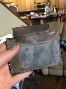

I ordered a new cat and it is ever so slightly larger then the one that was in there. There are 2 of these plates. If I remove them the new Cat will fit. Can anyone tell me if these are spacers? And is it ok to remove them? Thank you

What size gasket are you using on the cat? It should be 1/16” interam gasket, 1/8” will not work. The piece in the picture is a bypass retainer. It keeps the bypass damper in place, it’s necessary.

Also the actual combuster is slightly larger not just the gasket. With both of these plates removed the Cat will fit but it is a very tight fit
You most definitely need to leave those plates in. Who did you order the replacement cat from?

I found an old thread where BKVP stated that they used to make these stoves without these parts and that the damper could come unhinged if a person was to rough with the handle.
I almost think that this Cat size was designed for the size before these plates were added.

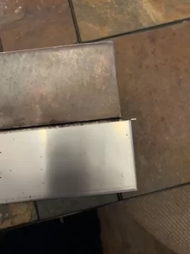

Here is the Cat that came out of the stove and I’m pretty sure is brand new from the factory up against the second one that was sent to me.

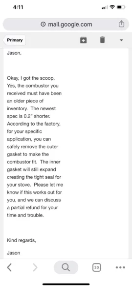

This was their solution by the way. Which doesn’t not work since you can not even get it to fit with no gaskets and both retainers in.
Right now I have no gaskets and only 1 retainer so I can at least use the stove and it would barely fit.
