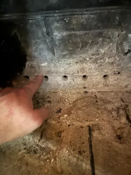

They’re out there all over and a great stove, you want a 2 piece back, start looking for one with tall doors and multi piece handles. Look for an “eyebrow” above the vent holes, this shows it’s a 2 piece and you can not only buy new firebacks to replace worn or cracked ones, as you see mine is, I have a couple waiting in the wings for rebuilds, personally I have never seen a Vigilant with cast or glass inserts in the doors that wasn’t a 2 piece.
