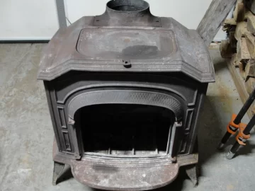

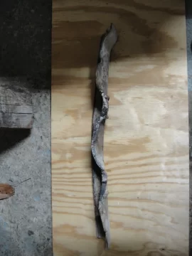

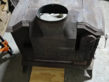

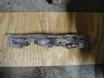

Attached are photo's of the Resolute 3 project. The piece attached to the fettle has two photos. I have not found this part listed or even a photo of it anywhere. At this point in the project with difficulty finding parts and pricing when I do I am going to list the stove for parts or repair and move on. Just wanted something to cook on, not interested in a stove restoration project. $200.00 is what I paid. Zip code 13126.

So nothing to loose in order to move the stove I got my tools out and completely disassembled the stove. Had to drill out some bolts and grind others off. Broke some bolts in the damper linkage and the damper, just twisted off the one going thru the damper linkage that was set up. Tried heat and penetrating oil. Started at 8:30am and just came in at 5:30. Took 2 ash cans full out of the interior of the stove, not sure it was ever cleaned. Being Halloween I'm not sure if this was a trick or a treat at this point.

After deciding to keep this stove disassembly to move it was the next option. I am trying to salvage all the pieces cleaning as I go. Already filled the vacuum twice. What I am wondering if anyone knows where I can find assembly instructions for the Resolute three model? I am using the ones posted for the Vigilant ( thank you) and was asking if there is more info for the Resolute III specifically? 😀 I was looking for assembly for the double glass in the doors if its necessary, the gaskets available and the andiron assembly that is needed to replace mine. Thank you all for the motivation and a new meaning for putting a fire under me to get me moving.
