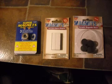

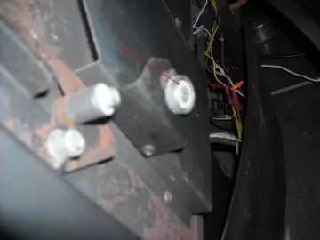

    Hello
    Both door magnets on this Santa Fe have no magnetism!
    Do you think any of these from AC Moore or Home Depot below might work?
    Click pics below to enlarge

    I can send you a piece of a hard drive magnet that will probably re-energize that one or you can just leave it stuck to the factory one because they are skinny. If you have any old or junk hard drives they are worth taking apart and removing the two magnets. I can tell you how to get the backing off the magnet. Use caution with them because two will cause a nasty blood blister.

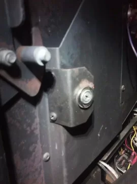

    The Home Depot super magnets with a washer seem to work fine! Just removed the old magnet and housing and put the new magnet and washer on with the same screw but no housing.
    The MFG date is Aug 2005. Other than the magnets and a bad fuse it runs great!
