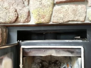

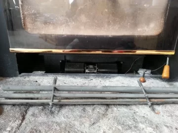

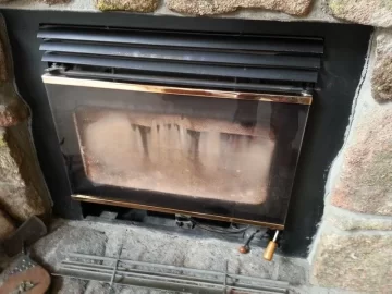

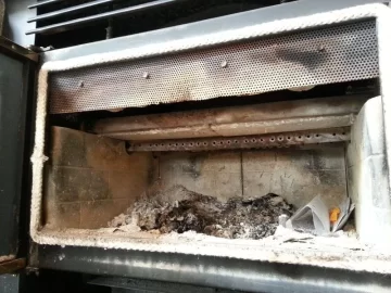

I'm not sure what my current wood-burning fireplace is classified as. It is an RSF Energy Onyx from back in 1994 or so. It has a closed circuit air-supply and chimney. I've been told it is not an insert. Here are some pics:

The first installer should have known better! I wonder what you would have ended up with if you had said ok?
That is a high efficiency Zero Clearance fireplace. Is there a problem with it? It should be able to make respectable heat, much more than a pellet stove anyway.
I would consider installing a freestanding stove somewhere else and keep the fireplace as is. It would money better spent in my opinion.
Besides, if you go with a pellet stove, you'll need it for back up heat for when its cold out and when the pellet stove is broken down.

Ain't gonna work. A pellet insert needs room that just won't exist in there. Plus it has to draw intake combustion air from somewhere in the back. And the exhaust would be in the back. And even if shoe horned in it would have to be completely pulled out every time you serviced it.
No way. Now if ya just cut that thing out of there even with the stone...
They also make window mounted pellet stoves, but who would want it?
If there's was anyway it would fit, it would have to be so small what would be the point? It would probably have as many BTUs as an electric insert.
There not much room to do anything in there. Ripping it out and putting something else plus re-finishing you are looking at $10K+
If there is room, perhaps you could install a "freestanding" pellet stove out in front of the current installation and run a liner up the existing chimney, if a chimney is what you have there. Then rock in the old opening to match. Might have to add a hearth extension.... If you are handy, you can do the rock work yourself. Save some bucks.
Edit: I failed to mention my idea would entail tearing out the old stove. There are different paths you could take, probably be well worth the $$ to get someone out there who knows wood and pellet installations and have him or her give you some ideas.
