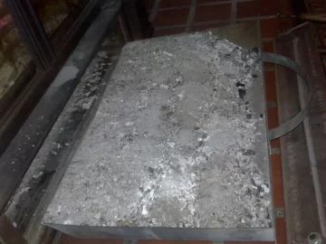

I just got home from 10 days in Florida, to the house set to 54 degrees. In an effort to curb the oil it would take to get the house back up to 66-68, I cranked up the stove, even though I'd hoped I would no longer need the stove this season. The 43 degree temp was too cold for me and I fired it up. I was pretty happy with the heat. Over about 5 hours, I only kicked the heat on about once for every degree. The stove (with the bad seals and one broken blower) still did the majority of the work bringing about 1500 square feet of the house up to 67 degrees. It was burning good and hot, and blowing some nice heat. Now it seems that maybe I've built up a little too much ash. I get some blowing out the doors and there seems to be enough to clog up the grates/bars in the front. My burnign is much slower and colder today. I've been working, so I have not been able to tend the fire much, but I think I've got too much ash.
My question is:
How often do you guys clean out the ash? Do you have any guides or rules of thumb you use? I.E. The ash gets above the first bar on the front grate. You have to clear cinders from the intake to the after burner. The pan is full, etc.
Here is a picture of what I had in my ash pan when my burn rate really slowed down... basically full.

What's it take you fellas to clean off the glass? How often do you run it that hot?
I just piled the box high with small pieces of wood with space between them, put some close to the glass, and left the air wide open. It did not clean the glass immediately, but when I walked back to the stove almost two hours later, it was clean (except for the sides where my seals are leaking). It seems that just adding a log or two, with all my ash, was leading to buildup on the glass (too cool of a burn).
Do you guys usually pile it high? Or just load a log or two?
After emptying the ash pan, and loading it up twice... the house is up from 67 to 70 degrees. Granted, it's 46 degrees outside right now. It seems I'm learning how to use this insert. I guess you guys ahve already figure it out, huh?
I don't let the ash pile up in the pan enough to clog things. When I add wood, I sweep the ash around and if it's slow dropping, I clean the ash pan out.
If you shake it back and forth a little, it comes out without pushing the top off the pile down behind it...
I use the Rutland glass cleaner, lotion stuff, blue... like oven top cleaner and barbecue grill cleaner.
Wipe with a damp paper towel to get the ash off the glass and loose stuff... then use a damp paper towel with a dollop of cleaner on it about the size of a quarter or fifty cent piece. Wipe until the glass is "clean" then buff off with a dry paper towel. Makes it pretty slippery after and stuff doesn't stick on it so easy. Wipes off clean next time too. Each time it puts another layer on.
