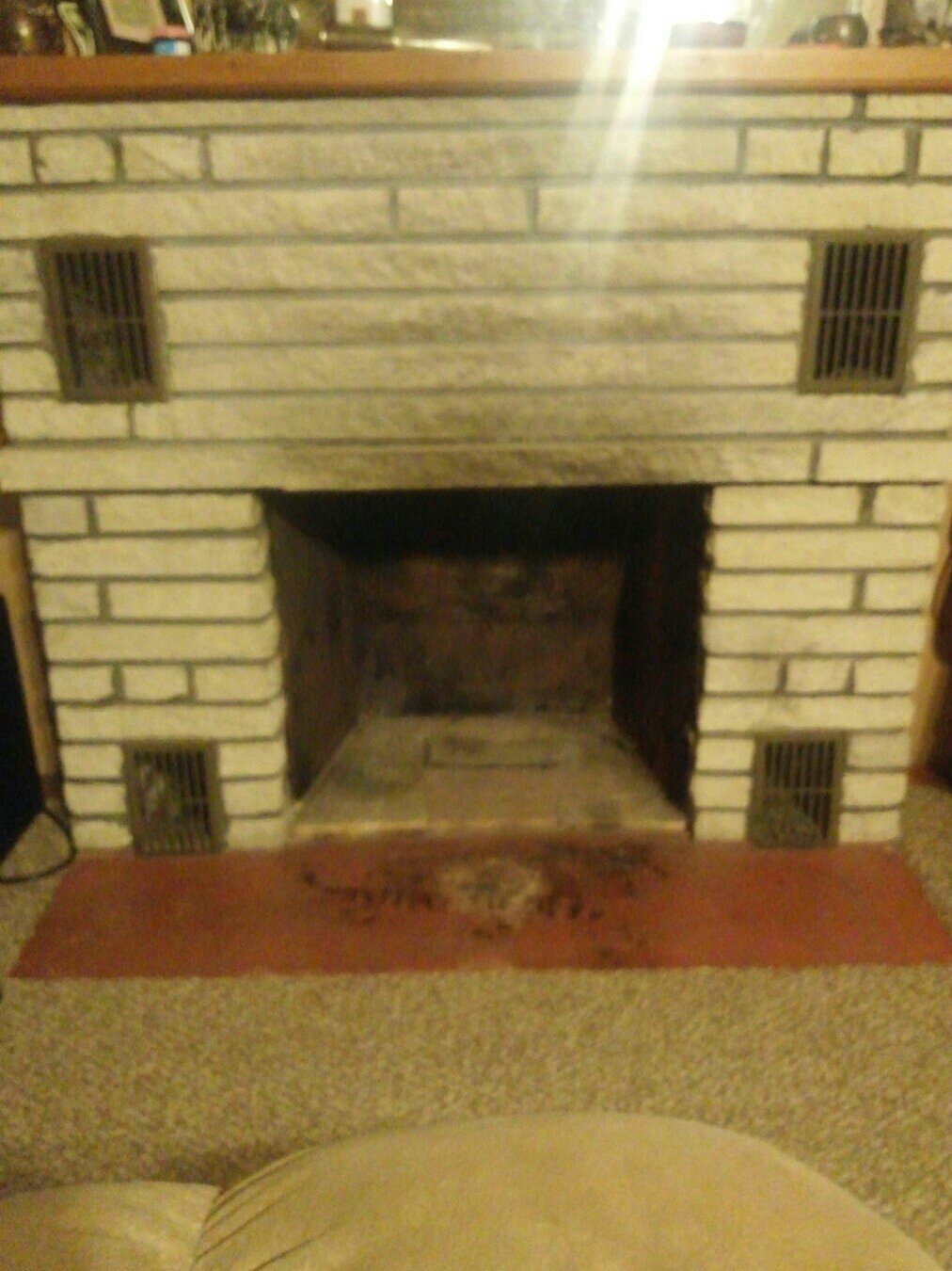

Not sure what you mean by chimney needs work (pic would help). I think you'll find most chimneys need work. As long as the thing is not gonna fall off the side of the house most can be used with a fullly insulated reline. And you might as well use it as it is a huge warm air draw. BY relining you can install insulation and a block off plate and put an insert or freestanding woodstove in the hole. It's a lot simpler than cutting a hole in roll for a new install.

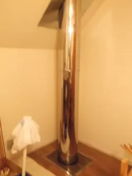

Link Removed Link Removed Also consider running the class A through the house vs. out and up for a significant advantage of draft and creosote prevention(stays warmer) I had my chimney professionally installed and this was the most expensive part of the deal for me but I wanted to make sure it met code and passed inspection. Since then I have helped install a few for others and the process is rather simple. Depending on code requirements you can leave some of it exposed and gain some heat in upper room(s) like I did. They wanted me to chase mine in but it passed insurance inspection after they saw my set up and the grate I fabbed to surround the through floor opening. Don't mind the terrible pics and mess - this is my primitive arrow making room and used to be the coldest in the house. Now it is toasty with the pipe running through there. It gets hot to the touch but not so much that it is scary. When the stove is full go at 700+ I can lay my hand on the class A but not hold it there for a couple minutes.

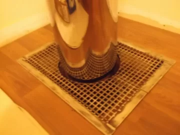

  • [Hearth.com] Questions from a ( soon to be wood burner )
Thank you gentleman for your honest replies. I guess the ol wonderlux is not an option. That is fine. My original fireplace is quite small and I was worried that by time an insert was installed, the actual capacity wouldn't be worth the trouble. I'll get a measurement and pic this evening.

Our inspector would not approve that installation. A friend tried to just have raw pipe and the inspector said absolutely not. The eventually accepted solution was a surrounding perforated stainless chase on 1" standoffs.
Begreen - that is exactly what my plan was if he did not pass it the first time through. I would fab up something nice that bolted onto place with some fancy expanded metal and iron work. I just really wanted the industrial look in there as well as the added heat.
An industrial look was the same goal I wish I had a picture of the final product. It looked pretty cool and was safe to touch and well ventilated.
At 25" x 24" H(?) I think you are going to need an insert. What is the depth of the fireplace at top and bottom? What is the H & W at the back?
Top depth is around 14 inches and bottom depth is 17 ish. Its like a metal shroud inside. Excuse my ignorance, I dint know much about fireplace stuff. I'm just worries that if I put an insert in, the actual fire box would be to small to Mess with.. but then again I'm not to familiar with inserts.
Yes, that looks like a heatilator fireplace and it is shallow. Only a medium small insert would fit I think, but that might be ok for 1200 sq ft. Take a look at a Buck 21. It might just squeak in there.
An insert will need a liner. This can be run up the existing chimney if it is not damaged.
