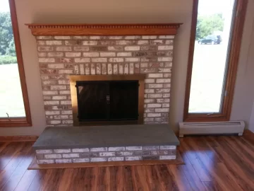

Welcome. Can you post a picture of the fireplace and some dimensions for the top and bottom depths and the H+ W of the front and the back of the firebox?

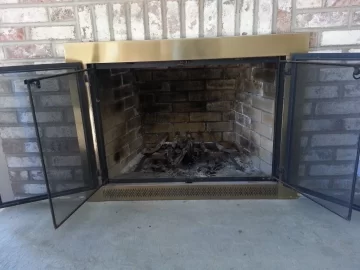

Fireplace opening dimensions are 34" wide at front, 24" wide at back, 25 1/2" tall, and 24 1/4" deep. Main level is probably 1800 sq ft. Upstairs is probably 1400 sq ft

That looks like you have an exterior chimney. You definitively should install an insulated liner or you may become problems with bad draft and creosote accumulation. What are the dimensions of the flue? How wide is the damper opening? You may need to cut that housing a bit. Make sure to install a block-off plate: https://www.hearth.com/talk/wiki/make-a-damper-sealing-block-off-plate/
And if there will be room in the back think about insulating: https://www.hearth.com/talk/threads/finally-got-around-to-insulating-my-fireplace.75755/
Did you take off the glass doors for the measurements? They will need to come off anyway when you install the insert. Check also the depth of the hearth as you need 16" in front of the insert or you may need to extend it.
For that amount of living space a large insert with a firebox size of 3 cu ft is recommended: Some possibilities: Pacific Energy Summit, Osburn 2400, Lopi Freedom, Lopi Large Flush insert, Quadrafire 5100i, Regency i3100, Enviro 1700 series, Blazeking Princess (catalytic). Kuma Sequoia or Buck 91 if you want to go really big and an 8" liner will fit down the flue. I think all those inserts should fit but check their dimensions.
Just checking. Are the fireplace opening dimensions with the glass doors and trim removed?
