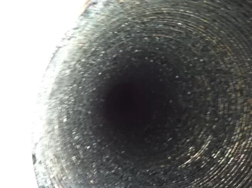

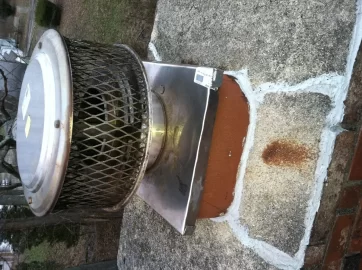

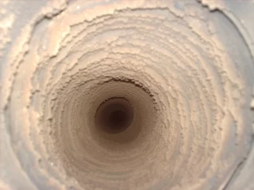

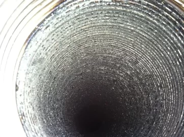

I've burned about 15 days since installing my insert and was curious what my liner looked like at the top. I popped the cap off and was surprised to see what looks like a lot build up for such a short amount of burning. I am burning all Ash that is reading between 12-20% on freshly split face with a Harbor Freight meter. Liner is 19 feet long, insulated, and in an exterior chimney. This is my first season burning wood and I've definitely had more smoldering than I would like, especially on start ups/reloads but once it is cruising there is no visible smoke. What do you think?
Additional detail edit:
I have a metal blockoff plate at the bottom with roxul above it but no roxul underneath the top plate.

So, just be clear, all that is from just 15 days of burning?
That bad huh? Well 15 days may not be exact but it my best guess.
Not good for a couple weeks but no real heavy build yet, but you are heading that way. Clean it up, burn hot and use dry wood, always.
Burn a bit hotter and recheck it mid January.
You're still learning your stove at 15 days. Don't sweat it, wait a while and recheck it.
I think your pictures of the inside of the liner are top looking down. Is that correct? If so, you're looking at the coldest end and where the most creosote will condense out of the smoke. It looks like the outer rings of the liner have collect the creosote but the inner rings are not coated. Based on that, I am suspicious that ANY convoluted liner will have this appearance in short order. IMO, I would burn another couple weeks, doing my best to avoid smoldering, and then check it. I wouldn't be surprised if it looks the same or maybe better at that point.
I suspect you are starting with larger splits or rounds since you're experiencing a lot of smoldering at start up. Keep in mind that wood is also a thermal mass, so it needs to come up to temp along with the stove before you'll get a hot fire. So what you want when starting cold is to bring the total mass of the fuel, the stove & bricks, the flue and the air moving through it all up to good burning temperatures as quickly as possible. The best way I know to do this is to use a lot of smaller rounds or splits. This will likely equate to a lesser total mass of wood and will have a lot more surface area. Those 2 factors allow the load and stove to come up to temperature faster and engages more of the fuel surface area a lot sooner. And more burning surface area equals more heat, warming the total mass of the load, the stove & bricks much faster and much cleaner. Once the start load has burned down to coals, then add a few small pieces under the larger splits or rounds for a long burn.
As JA600L said, kiln dried lumber makes great kindling and starter wood. Just don't use treated lumber or lumber with any type of finish applied. If you have it available to you, seasoned "splinters" (extremely small splits - say 1" diameter at most) of juniperus virginiana - common name eastern red cedar - also makes great kindling for initial starts and for quickly establishing flames after reload.
When starting a cold stove, I use 4 sheets of newsprint, cedar splinters, a couple pieces of 1x2 kiln dried lumber with small rounds & splits and never have a fail and it gets the stove up to temp fast. I'll create a tunnel with the 2 largest splits or rounds (3 to 4" diameter) laid east-west in the stove, one at the back and one in the front. Wad up the 4 sheets of newsprint and pack them tightly in the middle of the tunnel. Then I stack a couple of short lumber pieces north-south on the tunnel walls, then the cedar & lumber kindling east-west, then the rest of the rounds and splits on top of all that. Stack everything loosely so it all can breathe well. I also keep the draft fully closed on my stove and leave the door open an inch or 2 until the fire is going good, then close the door while opening the draft. Depending on your stove and draft, you may or may not need to do this. My PH and my draft combo makes it possible for my PH to vent out of the draft inlet if it is open. And it takes it forever to get going (smolders) if I don't leave the door open for a bit. But no other problems once the flue comes up to temp.
Using wood pellets over coals is extremely useful as well to bring the stove up to temperature. They are fairly cheap and make no visible smoke.
After trying this many times and seeing how much work firewood is, and worrying about creasote, wood pellet stoves really seem like a good alternative for a clean burn.
The Romanian Judge rates it a 7.45.
It doesn't look great but all that you can see is the very top of the pipe. There may be no creosote forming 5 feet down from the top. The end of the pipe could be the only part that is cold enough for creosote to stick to. Burn it hot and recheck in a few weeks. I would also get a Gardus Soot Eater and clean it from inside your house occasionally. All you have to do is let your stove cool off and spend 10 minutes with a drill to clean it.
The fact that you are up there checking it out and concerned and aware of what is going on puts you miles ahead of most people. As someone else suggested, get a broom and sweep it while you're up there, and check it and clean it again in another few weeks, and just keep doing that until you are comfortable with what's going on. The mistake that most people make is that they don't care about burning dry wood, they don't pay any attention to what's happening in their chimneys, and they never clean them, and sooner or later they get enough creosote build up to have a serious chimney fire. You are nowhere near that, and as long as you stay on op of it like you are, you never will be.
