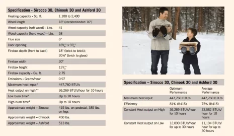

I know my Princess can fit 20" splits e/w, have an Ashford owner measure e/w. While I only load n/s if it saves cutting 20 cords down I'm game with the e/w loading for a few seasons. :)
I had similar issues when I when from my Lopi to my BK. The Lopi I cut most of it 18, the BK works better at 16-17 but 18 fits the second layer ok. Lucky for me a lot of wood comes from a local tree service which cuts lots of shorties. After getting one layer down I can fit the 18 n/s without issue.
EDIT: checked the BK site you may be able to make 20 e/w work. Have an owner measure and see if it's a hard 20 or a 20 with a little wiggle room.

I am an ashford owner. I also have splits that I thought were too long and cut for my old stove. You can fit 20" in. Its close to the glass but yep. It will fit. Especially the splits that go on top, you get another 1.5" when you get above the firebrick.
That said, if you can live with it, find someone to trade with. If you have to cut it, a large electric miter chop saw is the safest and best way in my opinion.
If there is any doubt, take a split to the dealer or bring some here. I'll show you how to burn 20" splits. I'm not far.

My stove is too hot and too full right now to confirm what shoot-straight says above, but it sounds about right. I left a tape measure out on my hearth to remind me to measure before the next reload. 15" splits EW have quite a bit of room down between the firebricks, and plenty of room NS between the brick across the back and the door glass.
EDIT: I would rather all my splits come in an inch "too short" than have one in fifty be a millionth of an inch too long.
