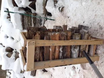

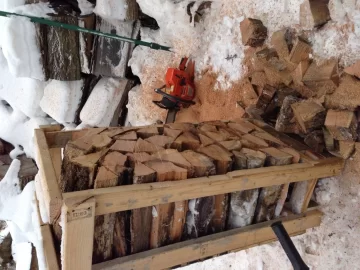

I had the same issue. I went from a Englander 30 the a BK Princess. I had about 12 cords at 20"-22". I made the jig pictured below and it works great. I don't have a wood shed so weekly I bring my wood into my attached garage via three wheelbarrows and the wood sits in the wheel barrows until it goes into the stove. I fill the jig cut it with my 28" bar in one cut then fill the wheelbarrows. Takes maybe a min to cut. The cut off pcs work great for in between fires when it's cold and can't get away with 12 hr cycles. Otherwise I fill it with the cut offs and then let the thermostat do it's thing.
