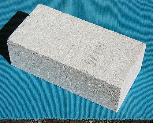

    Here's some more info-two different uses, you decide whether it makes a difference, there is a reason they use them IMHO.
    "Do not confuse lightweight insulating fire bricks with heavy dense firebricks. Insulating bricks are refractory too and of course withstand very high temperatures range BUT for purpose they have very low thermal conductivity and don’t absorb the heat well at all. [​IMG] Those are intentions for heat insulation. For instance if you used them for building of the hot face in a wood fired oven (for cooking) the oven wouldn’t cook, because it wouldn’t store and hold almost any heat. You can however use these insulating fire bricks on the outer side (of the heavy firebrick walls, vault or under the floor bricks and slab) to prevent the soaked in heat in the chamber’s body mass from escaping and achieving superb results. Meaning well insulated oven which will hold the absorbed heat in its mass, where it should be to cook for long time."

    The numbers left to right:
    MaterialDensity (kg/m^3) - Specific Heat (J/kg-C) - Thermal Conductivity (W/m-C) - Estimated heat loss(MJ)
    Ordinary Brick 1600 - 840 - 0.7 - 5.7
    Pumice Brick 770 - 835 - 0.107 - 1.5

    I'm of the opinion you should use the type of brick the stove was designed for. Using a denser more conductive firebrick could lead to reduced performance on some stove designs. At the very least you should try to find firebrick with similar characteristics to the ones currently in your stove.

    Ordinary Brick 0.7 W/m-C
    Pumice Brick 0.107 W/m-C
    A 7 fold difference in thermal conductivity seems very substantial assuming the bricks are of equal thickness.

    In a smaller stove I think a superior insulator would be even more important, especially when you want to have the largest firebox in the smaller form factor. This is why they are using more exotic insulation in most European stoves.
