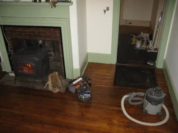

Hello; I thought I'd bump this thread because I'm now seriously looking at the Manchester and the Isle Royale but leaning towards the Manchester because I have a wooden mantel above my fireplace opening and thought maybe I would feel a little more comfortable with the convection style of the Manchester over the radiant top of the Isle Royale which if anything seems to run hot.
I'm wondering if anyone else has some experience with the Manchester to offer up or if anyone knows whether or not I'm right in assuming it would push it's heat more out to the front because of the convection design. I would love to buy the Isle Royale but I'm a little hesitant given my set up because it runs so hot.
I have 30 1/4" to the underside of the fireplace opening from the floor and 57" to the underside of the unprotected mantel and there is a heat shield surrounding the closer parts of the wood surround. Also I now have a non-combustible floor surface[copper sheet metal] 18" beyond the brick in the front. With the Resolute the wood barely gets warm but I worry about going to a much taller stove so any thoughts would be greatly appreciated.

The Manchester looks like a good choice. That's a very nice setting for a stove.

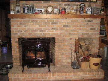

I wouldn't let the mantle height influence your decision on which stove to go with. I installed a Jotul F600 stove in front of our fireplace opening last February and the stove sits 32" high with our 11" wide wood mantle only 54" above the hearth. I installed an unobtrusive heat shield on the underside of the mantle and have had no problems with the heat. Here is a photo of my set up.

When I was deciding on a new stove it came down to the Manchester and the Jotul F600. I went with the Jotul F600 because the legs were a bit closer together (front to back) than on the Manchester. This was important because I was sitting the stove on a raised hearth and only had 17" to work with. The F600 legs were just 16" apart and by sliding the stove into the fireplace opening an inch or so I was able to get the front legs back two inches from the front edge of my extension. Also, the side door on the Manchester opened by swinging down instead of to the side, which would have made loading impossible from the side due to part of the door hitting the inside of my fireplace opening. The price between the two stoves was pretty much a wash, but the final determining factor was the fact that as a new stove my dealer couldn't get a Manchester in the Majolica Brown porcelain enamel we wanted until some time later and we were ready for a stove in February.

I went to their web page and looked at their diagram while they don't have a specific measurement for the legs (front to back) they show 20 inches across the top and if you draw imaginary lines down from the top to the outside of the legs it looks like it was too wide for my hearth extension. I had my dealer checking on the exact measurement, but then he found out he couldn't get the stove any time soon in the finish I wanted. Another thing to consider with the Manchester is making the connection to your T connector since you are going to have such a tight fit. The difference between the F600 and Manchester flue collar height is about a half inch. From what you have described it sounds like you will just squeak by getting into your fire place opening. I have five inches on either side of my stove and the insides of my fireplace. This allowed me to reach in from the side to make the connection. Will you have enough side room with your opening? I had about two inches headroom between the top of my stove and the top of the fireplace opening, but that was too tight to reach in from the top to make any connections.
