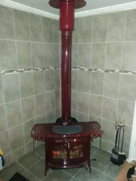

Can anyone give me an idea of what I could get for a 2010 VC encore 2n1 2040 bordeaux red stove? I'm considering trying to sell and replace with something I will find easier to operate.

Thanks for the complements on the stove. I think I bought this mainly for the looks, unfortunately. The issues I face are backpuffing and smoke smell in the house when re-loading. I have pretty much figured out how to deal with these, and perhaps my expectations on a different stove being easier to operate are wrong, but my wife doesn't even want to operate the stove because of them.
Unfortunately, this is not a stove you can load up for the night before heading to bed - you have to baby it and wait. The one that bothers me most is that I cannot seem to reload without the smoke smell I the house...this bothers me because I have children and air quality is a concern (I didn't have this issue with an older VC Vigilant). There is something about the air flow in the unit that whether front or top is opened you get something coming out. My wife gets ticked when I open up the windows in the room to freshen up the air and she freezes.

Chimney is 16.5ft of 6".

You are having draft issues. With the Encore, it drafts strong with a 6" liner and a 25' chimney and I never get any backpuffign even in mild weather. You have a far shorter chimney with an 8" liner. So, I think you have a weak draft.
Now, tell us about your wood.
With good wood on a good bed of coals, the griddle temps should get to over 600 degrees rather quickly. 15-30 minutes from reload and you should be ready for bed. With a weak draft and poor fuel, which I suspect is the case, you will struggle.
You should figure this out now before you put more money into this. Find a source of dry wood. Buy a few bundles at a store if you have to.

I too, think there may be a draft issue. The manual requires a min. 14ft. (I had to point this out to my installer who left me at 12.5 initially) Being that I'm a single story, and the stove is on the corner edge with shallow attic ( previous owner placement), I have 8 ft above roof and it already looks silly. I hesitate to add anymore up top because of balance issues even with the brackets I have attached to the roof, but also because of looks.

Offhand, 16.5 ft sounds like it might be enough height, but if your house is super tight, you may need to feed the stove with an outside air kit(see OAK) to get sufficient draft. If you haven't already done so in another thread, tell us more about your setup. . .tightness of house, located in a valley, any trees around chimney, etc, etc.
My wood was purchased this year (seasoned) from a local dealer - I have a mix of hardwoods, and the moisture level varies anywhere from 13.5% to 16.%.
My house is a 1950's cottage, 1 story, and isn't particularly sealed tight (i can feel air coming in from the electrical outlet right next to my computer). We are in a flat area (no valleys) and no overhanging trees.
