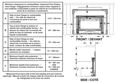

Clearances for the catalytic BK AF25 for example.
For the Regency CI2700
BeGreen,
Where did you pull the spec for the AF25 insert? We must have an old file somewhere. Here are the correct mantel clearances with significant reductions. AF25 Mantel Clearances.PNG
That's good to know. I got it from the 2018 manual. Looks like it has been updated with the 2020 certification? Going from 38" to 20" is a huge difference, almost half. The Sirocco25 had the same 38" mantel clearance pre-2020. What changed?
PS: When I went to get the new manual, the one posted on the site is in French.
BKVP
The original versions required a special section of ultra heavy duty liner (custom made for us) to the first 36". We added a baffle and that cured the issue of the added section of liner (which came with the unit) and dealers liked using the liners they each sell. The benefit is it reduced mantel clearance by quite a bit....

That's a great improvement and a win all around. With that big of a change, I would expect a model number update to 25.1.
BKVP
Unfortunately model change designation is would require recertification! EPA is very concerned about model number changes, seems too many things were tried in the past!

Yes, but this is such a major change that we need to be careful when providing info on clearances. When was this change made and how does one know which version the insert is if the unit is sold used? Did this happen after the 2020 certification?
BKVP
The change was made prior to 2020 certification, or that would have triggered a retest. Our site has been updated since the change. Perhaps you keep older documents elsewhere? Where did you pull up the older clearances? Thanks for pointing out the French version, that link will be fixed.

I keep old manuals as well as new ones. We get a lot of inquiries for old stove installations and new. And we often see folks here with other issues with older stoves so it helps with understanding how to service them. I've added the latest manual for the Sirocco 25 to the collection and will download the new AF25 manual too.

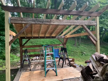

Been moving along. Wood shed is nearly roofed so stacking of wood to begin shortly. There is a Regency dealer near me and I have quotes for both the Pro Series Ci2700 and the Cascade i2500. Both look very comparable, with my leaning toward the more efficient Cascade unit. The latter is also quite a bit shorter, so not much manipulation in placement of my combustable material, and without having to use the OEM's heat shield. Visually, I like the bump out of the Cascade. The two units are within 300 bucks of each other, and each well under what I had anticipated for a budget, including install, and both are available in a couple of weeks. Pluses for the Pro series are a larger viewing area, but I think that's minor for our room depth, and it's taking slightly larger logs...but not an issue with the size of my splits. Steady as she goes....

I thought I was the only person on earth to use Simpson framing connectors in combination with hand-hewn timber, although you've certainly found a new way to do it! In my case, it was just a few post bases, to keep the timber off the concrete.
Ultrarunner
Jun 5, 2022
27
Ct
Yep, its more than needed, as plenty of air will be able to move through the shed, with no worry of the roof lifting off, I just like to over-build ;-)
The joist hangers on the lower forward "decorative" beam I will remove, once I shoot some long screws in, so the original tenons will show. I didn't have enough 14 foot beams so had to go with the lumber 4 x 4's at the front, but have enough of the barn material to wrap them to blend in with the crowd.
I have enough structural barn posts left over (stuff that folks in Old Greenwich use for mantles) that I'll likely sink a couple and do a lower shed roof off the hidden back side and back, so as to have more covered area for wood storage. When done, maybe 6-8 cords under cover. I have 30 feet of covered front porch of the house that'll store a fair amount without have to stack too high over windows. So, easy logistics for daily-log loading, and I can restock easy enough from the shed.
Should be a reasonable setup and easy for wifey and kiddos to restock the stove when I'm on a trip. Fun times.
