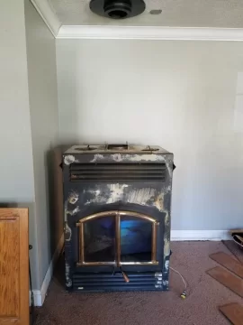

70 degree day what is that? lol its actually been nice the last few days im installing now. I'll fire this sucker up later. Im gonna give this 6'' stove pipe a test.
Gotta go pick up some blocks to set this on.

so I got a fire going and I have question, It seems to draft ok. My question is when you add wood do you have any issue with smoke spilling out? I know you said you are using 8'' stove pipe. I was gonna install the 7'' but im wondering if I should install 8'' ?
Please don't burn in that any more without a hearth.

That's a ZC fireplace, not a freestanding stove. It can't be connected to the current ceiling support with stove pipe. It has to have the required chimney pipe from fireplace top to chimney top.

Yes if I open both doors I will get a small amount of wood smoke but then it'll start drafting up the chimney. What I typically do is crack the right hand door then open the right hand door then the left hand or both of them in a slow manner. I would say go with an 8-inch pipe the more draft the better plus I'm not sure if you can get 7in and a standard chimney not the ICC chimney ICC chimney cost some Bank
Looks like it's connected to me
Yes but are there cooling channels in the fireplace that need to be hooked to the air space of the chimney to cool properly? Is there something else that is effected by not using the proper chimney
@jjfmetal This is not a proper or legal installation. It is dangerous. Stove pipe is not for use in an enclosed space. The fireplace must be connected with ICC 7" chimney, only.
8" doesn't mean more draft it means more volume with less velocity. And the chimney need to be one specified for use with that fireplace
From the manual -
This fireplace is certified for use with 7" ICC Model EXCEL chimney only.
This is some valuable info I did not know I know my stove is installed by qualified dealer before I had purchased the home now I'm curious to look to see if I have the correct chimney or not
This is required for some fireplaces but not the RSF. It uses ICC chimney with solid pack insulation.
Okay now I'm confused when people are talking about how their stove drafts what are they talking about?
How a stove drafts depends upon many things. But basically it is a combination of the negative pressure in the chimney and the volume and velocity of the gasses being evacuated from the stove.
