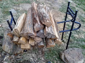

Had a pile of slightly-long splits accruing, wanted to halve them. Took an old weight bench, couple screws removed from it to remove the plywood bench, flip 'er over and there ya go. propped low end on chopping round and filled 'er up a few times. Put some splits I didn't need cut at end for "Buffer" to stay away from metal.Splitting round also helped with that.
Brace with big rocks or circa 1988 sand-filled weights.
Now wife has "her" pile of smaller splits to start up a burn easier. Stove takes 26" splits, but they are unwieldy for her.
Could easily see used for poles, too. Plan to brace long ends with other wood/rocks to get height, and cut, slide, repeat.
