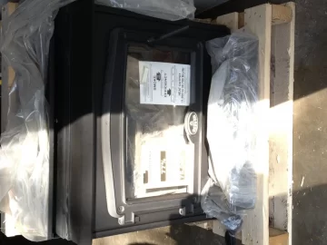

So I had my Osburn 2000 insert for one year and as I have reported in the past I had issues with the left side or hinge side of the door sealing. Well I replaced the factory door gasket with a bigger one courtesy of SBI to help seal the door better and it seemed to work, then the door handle froze up and SBI sent me a whole new door with no issue. Then SBI was looking into the issue and felt it could have happened anywhere along the chain before it got to my door and felt it would be best to replace the whole unit , so today I received my new Osburn 2000 wood insert. Bert from SBI is a very courteous person who helped me along the way and made this super easy on me ( thank you Bert very much)

Thanks for the update. It's good for them to pull back a bad unit and analyze what went wrong. Could have been built on a Friday at 5pm, with happy hour beckoning. How is the new unit's door sealing?

Its still in the crate but I did try the dollar bill test on it and im not exactly sure what a pass is. I can pull the dollar out and it takes effort to do so, it is snugg. Im not sure if I shouldnt be able to pull it out. I tried the test on the new unit and the old unit and they seemed about the same only difference is the old unit has a bigger gasket compared to the new unit.
The dollar bill test sounds good. You should be able to pull it through with a little effort.
Reactions: etiger2007
"Snug" is good. Dollar not staying in place = bad.
Sounds like your new unit is ready to be installed.
