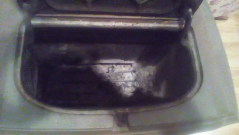

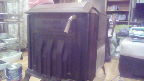

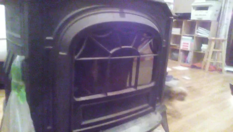

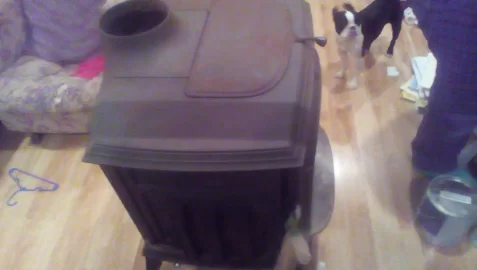

I think I did pretty good on this one. U guys decide.
Craigslist score. Vermont castings resolute acclaim. 200.00

Depends on the innards. The refractory went pretty frequently with this model and is expensive to replace.
Well it looks pretty good but I need to vacuum it out to make sure the refractory material is good. Even if I have to replace it it is still a pretty good deal, I think.
sorry to rain on your parade, but one of the worst stoves VC ever made. Parts add up $$$ and need to be replaced often. Throws most of it's heat out the back. Hope it works out for ya. My comments come from a dealer point of view......a dealer that delt with a ton of pissed off customers who bought that stove.

How bout nice looking stove for that price. Haven't read any good stuff on vc pretty much at all
According to the owner. It was bought new in 2000. And was us for four years. After that it has been in storage. I checked the refractory material and it looks ok to me. Holes are still there and they are the right size. I have to admit I wasn't aware of the baggage that comes with model I hope it works out. But on bright side it's probably worth the same amount for scrape that I paid for it.

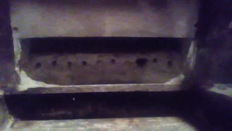

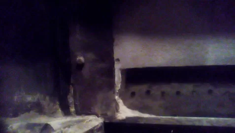

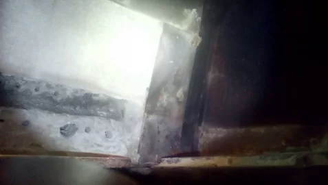

Ok here of some pics after I cleaned it up a little and took the bricks out

Definitely appears to be falling apart some... haven't seen them first hand but have seem many photos... seems like there may be some use left in the stove....
Isn't there a refractory package that needs to be accessed? Think it would be important to see that area. That huge crumbly hole is concerning though and could be an indicator of badness in the refractory area.
I am no expert in anyway though. But you have to be very careful buying used VC stoves.
The refractory package is breaking down. It may have a season left in it? It's $229 to replace at Black Swan. Do the gaskets at the same time. Repeat every 3-5 years.
