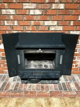

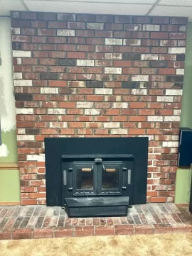

Hello - we have an old wood burning cast iron fireplace insert with a blower that we are trying to remove. It's a Sears Forester - super bulky and heavy. Model number 143840600.
I've taken off the doors, cleaned out the ash, removed the firebricks, etc. My husband, 16-year-old son and I tried to pull the insert out of the firebox and it won't budge. Not even a bit.
There doesn't appear to be anything attached inside but as far as we can tell it is a very tight fit in the box at the top and bottom.
Does anyone have any experience removing something like this? Is it just that it's *that* heavy that three mere mortals can't make it budge even a little or is it possible it's attached in someway at the bottom or top that we just can't see? I don't see anything going up the chimney from the insert and we have the Owner's Manual with installation instructions - no mention of attaching it to a liner or anything like that.
Any advice on getting it out of there?

Your going to have to remove the surround 1st. It may be hooked to a liner, or the adjustable feet may be in a hole.
Yes, as mentioned, start by removing the surround, then you'll be able to get a look to see what's going on. The surround should be 3 pieces of metal that cover the opening around the top and sides of the stove.
My Osburn insert has nuts welded to the sides at the bottom so you can bolt it to the fireplace floor. Not sure if your stove has anything like that, but it would explain why you can't budge it. Once you remove the surround, you should be able to tell if it's attached in some way.
The bolts are to level and take the rocking out of the insert. If the original fireplace floor was damaged, which a lot are. They could be resting in a crack or hole in the brick. I'm doubtful there's a liner but it could be a direct connect type installation with the stove pipe into the chimney. Hard to say. Appears they almost have the surround pried off though
Once you get the surround off you can lift the front edge and get a wooden dowel under it so you can essentially roll it out.
Thanks for all the replies. There were two bolts on the surround that I was easily able to remove but the bolts that connect the surround to the insert are behind the surround and about 18 inches or so deep. I had to pry back the surround just to see that much, so I can't easily get the bolts off that hold the surround on.
The directions we found that come with the insert say put the insert in the box, fit the surround where you want it. Then, pull the insert back out using the roller (at the very back and bottom of the insert) and attach the surround to the insert and then shove it back into the box. So, it had to have gone in with the surround on, which is why I can't figure out how to get it out.
There are no instructions about it going up into the chimney and there's nothing visible from the opening so I don't think that's the case.
