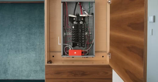

Not the cheapest, $299 and Solar adds $50. The install wasn't to bad, the hardest thing was finding a spare 220 circuit I could dedicate to it. The clamp install was easy.

Ok, ya that's up there - and didn't realize it also needed a 220/240 circuit. That seems a bit odd. Pretty neat though, regardless.
You can share a 220 but it is better to have a dedicated one, it uses that and the clamps to read the difference in the electrical signatures and to power the unit (it doesn't use much power itself).
How would you legally tap two devices off the same breaker? My recollection is no wiring junctions permitted within a breaker panel, and double-stabbing a breaker is also disallowed.
As per their install instructions:
Connect the power
Connect the black wire and the red wire to an empty 240V breaker and the white wire to the neutral bus bar. Sense draws less than 0.1A, so you should use the smallest 240V breaker available for your panel.
Don’t have an empty breaker?
Connect to an existing or add a new 240V breaker. Do not use a tandem breaker, unless it is 240V. Learn more at help.sense.com.
Oh no, you can have junctions and wire nuts in the can (panel box). You can certainly have more than one “load” per 240 breaker. Some devices require dedicated circuits but they’re specific.
Sorry for missing this one. As someone else replied, code allows multiple circuit's to be fed from one breaker. The key thing which is not code is unless the breaker lugs are rated for multiple wires (very rare, darn close to non existent) you can only have one wire per lug on the breaker. So you just run a short wire from a lug on the breaker to a suitable wire nut somewhere in the panel and then connect two or more circuits.
Note that PV circuits are an exception and need to be connected to a dedicated breaker permanently labeled with no other circuits on the breaker. On most panels, the PV breaker also needs to be installed at the farthest location away from the incoming feeder breaker.
