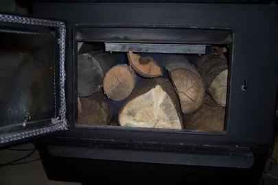

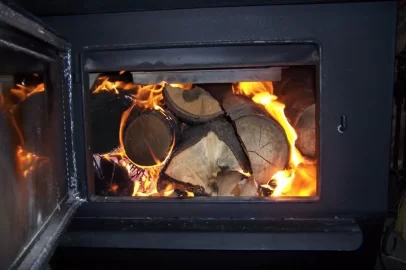

23 hours after I filled it last night:
burned down the charcoal, pic 1: spread the coals out 2 load with spruce & birch
3 fire started 4 fire going good 5 close door & bypass 6 get temp to mid range (temp ?)

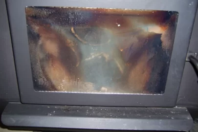

I set stat to just above 1.5 probably 1.6 house 73, OAT 32 ° f, 15- 20 mph winds. 2300 (11pm)
1. After a few minutes fire starts to go out, some secondary burn flashes dance around for a few minutes
2. 5 minutes no noticeable fire
3 20 - 30 minutes as stove cools, stat opens a little bit, gets smokey,
can see some orange glow at the bottom under the wood.
glass gets smokey & more black
Puts out heat all night, the temp probe (thermometer) goes below the "active" mark
tomorrow morning, turn to 1.75 - 2 & in a few minutes flames, lots lots more heat, house in the 70s within an hour
I'll be curious what the spruce did, 2 med spruce each bottom-sides & 1 big one in the bottom middle & med spruce top left the rest is birch on top

2 hours later no changes made 1.6 setting, house 72 ° F @(0100) 1 AM
(i woke up & had to go check)
No visible flame. Can see some smoke moving around thru the glass.
Stove is cranking out allot of heat , dim orange glow on the catalytic
Glass coated with smoke (creosote?)

Are you going in one step from the initial burn off to 1.5? I find that if you get the cat well lit and do a couple steps on the way down, you won't get the smoke and the cat stays nice and bright all the way down and into the low burn.
That's a good idea, I'll try it. It makes sense, for the cat to stay hot & less smoke inside the stove.

I thought about just filling it, with the coals in there the cat is in the active zone on the thermometer, setting it to 1.5. But I'm not sure that'd work.
I'll try a slower turn down in steps to see if I get less smokey glass. (though the black burns off when I burn hot, if it gets cold again)
