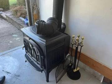

Does anyone see anything glaringly wrong with this thing?
[Hearth.com] Should I buy this used F500 Oslo?[Hearth.com] Should I buy this used F500 Oslo?[Hearth.com] Should I buy this used F500 Oslo?
It's looking pretty good to me. Obviously can't know for sure until I see it in person. It's about a 2 hour drive from me, which I don't mind. Basically a one-owner, as the people who are selling it said it came with their house which they bought 3 years ago and they have only used it a handful of times. Comes with the paperwork from original purchase in 2005. They're asking 1800 which I think is decent because includes the heat shield and a bunch of class A pipe, some seemingly single wall pipe, the steamer, screen and fireplace tools. Probably won't use a lot of it but I can sell some of it in that case. Might try to talk them down a couple hundred bucks when we show up but I'm feeling like this might be the one.
Install question - if I'm installing it in front of a brick chimney with a thimble, can I go minimum clearance even with single wall pipe, or do you still need double wall in front of a non-combustible surface?
Looks like a blue-black enamel version which is a personal favorite. FWIW, the stove sold for about that price in 2005. I think a bit of a discount is worth discussing first. The class A pipe is a gamble depending on the condition and brand. The steamer is a visual, worth $100 used. See if they will take $1500 considering the drive and all.

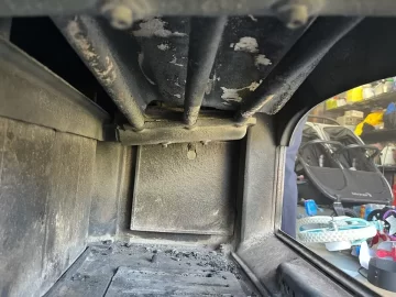

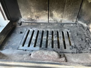

Overall is appears to be in good condition with low miles in spite of its age. It would have been nice for them to completely clean out the firebox to see all the grate's corners. A straight-on, inside view that shows the whole baffle would be good so that you can look for warping.

I'll get those!
Nothing jumps out at me. 1800 seems fair. Clearances are just to the nearest combustible. So if you are certain there are none near within listed specs you are good if it meets single wall it Will also meet double wall distances. I’d use double wall if at all possible.
