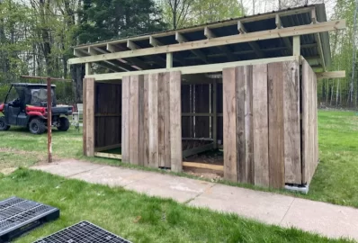

Nice. That looks like it will hold a good amount of wood...maybe six or seven cords.going to expand wood shed, I hope wood will dry !
length are 52 feet should hold between 20 and 30 cords theoretically. Yes, pallets to raise the piles of wood, and also leave space between the rows. The air flow is there being a tunnel open at the ends. It would have been better left out but we had 1 month of rain, and I'm waiting for another load, to be unloaded as close as possible to the entrance, for less work !Nice. That looks like it will hold a good amount of wood...maybe six or seven cords.
What are you going to to do ensure air flow through the stacks? Raised flooring (pallets or decking)?
Yes. Think about easy access to each year's worth, both while splitting & stacking, and then later when retrieving. That will dictate your stacking plan or organization in a large single structure.considering 3-4cord per year and considering 2 years seasoning ( to be sure low moisture ) I think it'll be ok if I keep 8 cords in. Is this a common way of reasoning?

Given the space you have, I'd keep a central path open for air flow, and stack (10 cm off) parallel to the walls, so you can access anything you want, rather than one solid stack accessed only from the two ends.
I.e. create an avenue between the stacks..

Nice. Agree about the separate wall in the middle as then you have 3 and 3 on each side. Not sure how much wood you burn but that may give you close to two seasons with one dry and the other drying.All filled up! Should have about 2 years worth. 6 cords total.
