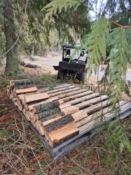

Well its a start. Found a guy on FB marketplace selling dry wood. Had to drive 35 miles to get it. 3 years in totes and under cover. I've got two different pieces sitting inside for moisture testing after splitting tomorrow. The wheelbarrow was light, they feel light and bang together like they should. I may buy up another load or two from him. The space needs to be 18" wider for three deep, and not be so close to the neighbors wall. I've got two racks built, but will go DIY with concrete block for next racks. Once I have enough for the first year I can get a larger delivery, still looking for a good supplier, or i go cut my own at relatives property

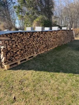

Wood from BIL stacked and covered for 3 years, its also dry, I tested a piece a few weeks ago.

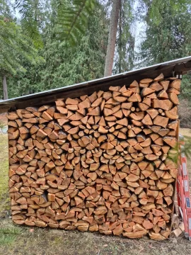

The oak in this rack was too wet, need to test the other species. I'll relocate it to the main area and keep dry stuff next to the house.

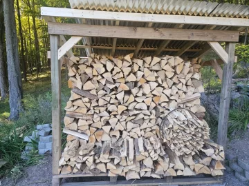

Finally got 4 racks built. 4 deep after seeing i left too much room between them and extended the area. Three different designs, they are 2-4" apart now. I had to unstack, move and restack 1.5 racks. One metal rack is full next to house for quick access. I might try to build the next one more connected to each other, build in the garage or flat spot of yard and set in place. I've got more than one cord of dry wood, 9-13% moisture, picking up one last load from the same guy. But now he is out of this dry wood. Will buy a full cord from another supplier and have it delivered, let that dry for fall 2027. Now i can work on cutting my own at relatives place.

Well done! I was watching a you tube video from a guy that built 3 racks with 2x4 and concrete blocks like the left two rows.
I'm building some racks when the winter lets up and I will post my pics as well.

I filled the concrete blocks with gravel to keep the posts upright, using the landscape timbers on the far left one. Trying to be tool free, its quicker. If I have to build 8 more racks, it has to be more efficient and permanent.

The one on the Left will roll the concrete blocks over time. The angled 2x4's will often lever them over at least partially with the weight of the top rows pressing against those 2x4's.
The other one with the roof looks much more secure but that metal roof looks like it wants to slice your jugular every time you put a split in or pull one out.

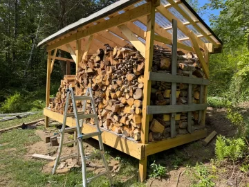

I don’t think I’ve posted the shed I built this summer. It’s 7 x 16 ft, pretty tall at the front. I stack it pretty high using my tractor bucket to lift up to the top of the stack, and I can reach the bucket into the shed before the front blocks it. This is for ‘27-28 and beyond. My this-winter shed is at the end of the driveway, so the snow (vermont) gets cleared and I can wheel my cart up to it. I didn’t have room at the end of the driveway without blocking things up and getting in the way, to have more shed there. The trouble is that I’ll have to move this dry wood into the current-winter shed next year, more moving of wood than I would like. But I may be able to grab some of this wood when dry directly before the snow falls some years, and I also may be able to put wood directly into the driveway shed if I think it will dry fast enough there if there is space. The shed is a bit more full than when this photo was made — split more pine and butternut, and cut some ash. In the closer bay, a row of hard maple (already 12 months cut and split, mostly), a row of ash, and then the front and back unfortunately are pine and butternut. Took down very large pine and butternut trees this spring. Crappy wood, but I’m not going to throw it away.

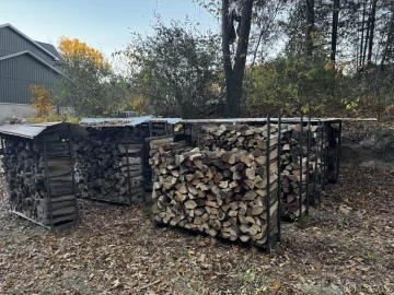

More of covered racks than a shed. I can pick them up with the tractor and put them by the basement door easy enough.
They’re all angle and c channel welded together with removed pipe for arms. And all heat treated for corrosion resistance. Been outside for 10 years now and still looking good!
