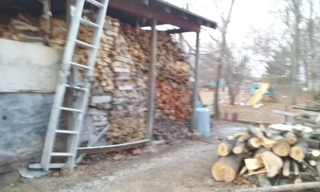

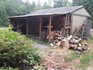

This shed I built in August. Inside dimensions are 7' D x 12' L x 8' H to the top of the plate. To make it easier to stack, I put 4' wide welded wire up the ends. I don't have the land to stack in drying rows before I put the wood in the shed. With the first leanto I built in 1975, I found that wood in the middle was still not seasoned after 3 years since it is only open on 3 sides as the back is the cinder block wall of my shop. That one there is 8'D x 8' H x 19' L. I think many people might be making a mistake when they board in 3 sides on their sheds. (That is, if they are putting unseasoned wood in there.) I also have another shed I built 3 years ago that is 14' L x 4' W x 8' H at the front & 6' H at the back. That is open on all sides.

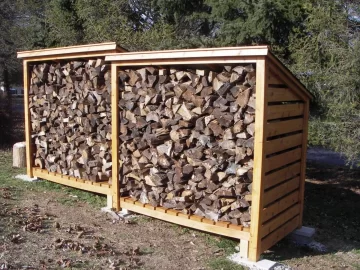

Here is my new shed.

Here is my 1975 shed. I know, it's a lousy picture.[Hearth.com] Show us yours! Wood shed
Nicely done and nice write up, but do you find that open all around is drying the wood in the center? I'd like to know since I will be building a shed some time this year and I will probably stock it with semi seasoned wood.

I'm hoping it will. In my original old shed with with one side being the cinder block wall of my shop, I find that even after two years the wood is not as seasoned as I would like it. With semi-seasoned wood I think you will be OK unless you are putting oak in there. With the new open shed I'll let you know in three years.

looks great!! how many cord does that hold?? and did you go off any plans or just on the fly building it??

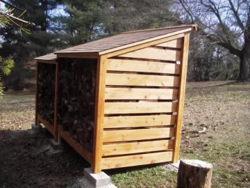

Thank you! The wood shed easily holds 18 cords but I use half of the first bay for yard tools/equip so I have about 15 cord in it now. I designed and built the shed myself. The shed overall is 24x12 with 2ft overhangs all around (so roof is actually 28x16 to maximize sheets of plywood, 14 sheets total). Each bay is essentially 8x12, and height goes from 9ft in front to 7ft in back. Posts are 4x6x10 PT set on concrete piers, roof is 1/2in plywood w/metal roofing on top. Let me know if you want any other info.

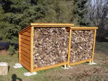

Thank you. the woods are Poplars, White and Black Ash, Red and White Oak, Elm, some Ironwood. It is at MN (Minnesota). The picture was took in 2011 (first winter). This year about the same but more Ash. Have other two area where the piles sit on several pallets to be dry for abt two or three years then move to wood shed. Will post two more pictures soon.

Just curious, but that roof looks quite flat for Minnesota. Aren't you worried about the snow load? I see a slight pitch to the roof, but not much of one.
I built a lean-to shed with a similar slight pitch here in central Massachusetts, but it's only 9x12 and I can rake it if the snow gets too high on it.

Abt 1.5 foot down from front. Last winter got lots snow on it and didnt rake it and the roof still holding. space abt every 16". I can take picture under the roof to show how it look like. Everything hold with lug screws, deck screws, and roof screws. NO nails!

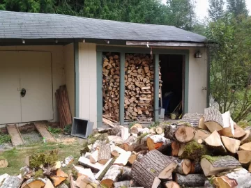

So I notice almost all woodsheds are open at least partially. My woodshed is a converted tool shed completly enclosed with no airflow. I plan on putting seasoned wood in it for the upcoming winter but am concerned about possible mold issues as there still is some moisture in the wood. Has anybody had problems with an enclosed shed containing seasoned wood?

I have seen some mold even with all the ventilation my shelter provides so I would imagine you're gonna get some mold.. Mold doesn't concern me too much if it is outdoors and will happen however you may get too much of it with no ventilation..
