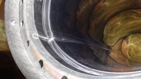

Unfortunately I received some pretty dented up pipe that I want to return. Also the top of my telescoping piece inner layer seam is a little wonky towards the top. How does it look to you guys? It should be ok to burn with right?
