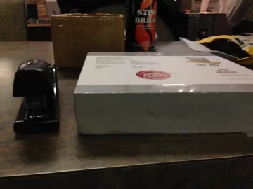

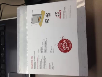

We have been using this product for fireplace enclosures, but i would guess it would be a great all in one hearth pad material. Any engineers out there could look at the specification in the photo and tell me if it would hold up to the weight?

Yes, Skamotec 225 can be used for Hearth Pads, stove stands and hearths. The compression rating is 406 lbs / sq in. You would simple finish it like your enclosures (tile) and lay on a flat surface. Skamol is also exploring the tests to allow Skamotec 225 to be applied directly to the wall (no air gap) to reduce clearances on the back wall for wood stoves.

R2.48 per inch, that is slightly below micore 160 if my calculations are correct. What is the advantages over Micore?
