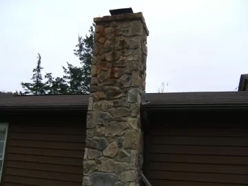

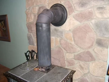

Hi,
Guess I'm a bad measurer. It's approximately 18 inches where the straight connection meets the bend which joins another connection into the wall. From the wall to the front of the stove pipe is about 19 inches. I'm uploading a picture also one of the chimney outside. The outside wall to gutter is about 8.5 feet and the chimney is about 4 1/2 feet taller, just guessing.

Hard to tell from that angle but it looks like the top of the chimney isn't as high as the top of the roof ridge. I'm no expert on this, but it may be possible that if the wind is coming from the other side of the ridge, draft could possibly be hampered. Make a mental note of wind speed and direction when the stove doesn't seem to be drafting as well. Where does the prevailing wind come from, in relation to the ridge?
Measurements are critical here. We need to know the measured distance from where the stove pipe enters the chimney to the cap. From the picture it looks like this could be less than 16ft, perhaps by several feet. Also, it looks like there is a 6" to 8" increaser going into the chimney. Is there no stainless liner in the chimney? If so, and the chimney throat is large, say 8x12, draft is going to be weak.
Well, I never had a head for heights and I doubt if I'll develop one after 70 years, so I can't get up there and measure. I chimney is taller than the roof ridge, but not by more that 2-3 ft. There is no stainless liner in this chimney, it's a fairly new chimney. but it has a ceramic liner. The stove pipes look to be 6 inches. The chimney itself can't be 16 feet high as the house at the gutter is 8.5 feet and the chimney above the roof is no more than 4.5 feet. It's been chilly enough the past few days for me to keep a small fire going in the stove and it's not been smoking like it was.
Thanks for your help.
The top of the chimney is higher than the roof, but not by a whole lot, maybe 1-2 feet. I don't have a clue where the wind is blowing from as it's not been blowing enough to tell. Next time it starts up I'll try and see. The house is oriented sort of east to west, but not exactly.

Let's guess the chimney is 12 ft up from the flue connection, plus the 18" off the stove would equal 13.5ft. The stove requires at least 13ft. of chimney so on paper this sounds close but the two 90 deg. turns in the smoke path slow the smoke down. So does the increase in pipe size. For better draft the stove will need a 6" stainless steel insulated liner in the exterior chimney and no increase in size a the chimney thimble.

The taller insulated liner drafted better and likely made the stove run a little hotter and cleaner. Also, the smaller insulated surface of the liner heats up faster so it does not accumulate the creosote as much once it is hot. The larger tile liner takes longer to heat up so the hot gasses hitting the colder liner helps creosote formation. I also think the liner should be on your wish list! It least it is not 30 feet so it should not be terribly expensive. maybe look for a good sweep a little farther from home? http://www.csia.org/

With dry wood and an insulated liner there should be little creosote buildup over the season. The current setup is slowing down and cooling the flue gases too much.
