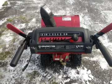

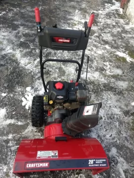

The augers and impeller are usually driven by the same belt/gear box. With machine off can you freely turn the augers? And what they said. What machine is this. And pics might help.

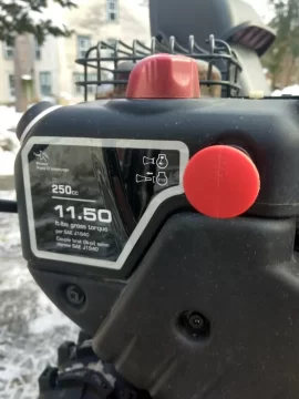

It's a Craftsman 31AS6WEG799
247.886900. It meets ANSI B71.3 2005 safety std. It's got a B&S 250 cc engine with 11.50 ft lbs of torque.
In other words, I think it's an mtd build.
The manual does not refer to an impeller shear pin, and does refer to an impeller drive belt. The augers look to be direct shaft drive to a gear box. So I am thinking the augers and impeller are independent.
