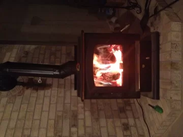

Ok, i got some decent wood been s/s for 1+ years to burn and see what happens. After burning wide open for the past 2 hours, im still getting stove top temps of 350-400 with a healthy bed of coals, flames blaring, and fan off. I also have a temp gauge on the side of stove and that one is reading 450-500. If i was getting a bad draft wouldn't I have problems with smoke pouring out during reloads, because I don't, not at all.
I would think so, but someone else may have other ideas.
But we should still talk about the wood. How did you come by the new wood? How decent is it? Do know the actual moisture content? What species is it? Oak, for example, may take 3 years to be dry enough to burn. Sorry to bombard you with questions. It's terrible, I know. But I'm not sure the wood issue is really solved yet.
EDIT: Are you using the same thermometer for the sides and the top? Those temperatures don't sound right to me. I wouldn't think there would be that much difference, and 500 seems more normal. Anybody there with a 30 that can talk about side temps? Bluedogz?
I bought the wood and its hickory, cherry, walnut, ash, and a little oak. Just split and checked with mm. Still higher then I thought, but around 22. Two different Rutland temp gauges, the tractor supply special. Ill post a pic.
Okay. 22% isn't bad. I'm out of ideas. Could you swap gauges and see if they agree?
BTW, I have heard complaints about Rutland stovetop thermometers, but not sure about specifics on that.
I had the two gauges side by side and they read about 25-50 degrees different. Maybe I should get a infrared thermometer before I go any further. The guy I bought my wood off of suggested taking my chimney cap off and possibly lengthening my chimney, would that really change a thing?
Well, I'm really not a chimney guy, so I'll defer those questions, except to say that taller chimneys usually draw more, but frankly, I'd be more concerned about the fact that its so large and uninsulated masonry, which is really contraindicated for a stove requiring 6" stainless all the way up.
I really think the next step for you ought to be a qualified chimney sweep/installer well versed in the requirements of your type of stove.
How many 90's do you have? This chimney is outside? Your chimney is a big part of the problem I believe.
Oldspark hit it on the head. Even using seasoned wood, you're still going to fight with that chimney. 8x8 of masonary outside is going to take a loooooooong time to heat up to give optimal draft.
