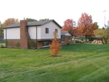

It's a foot shy from being the 10 and 2 length, and is nowhere near as tall as the peak of the roof. It's on the west side I the house not the east which is where I get almost constant wind from. Apparently with the two combined I think he said I'm trapped in the " wind eddy" or something like that.

That's a nice looking chimney but these guys are supposed to know what they are doing and they built it too short-not good.
+1. I like the looks of the chimney and house. Glad you are getting it figured out, but bummer that the chimeny is too short.
Hope it works out that is a nice chimney.

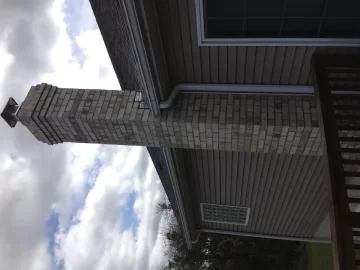

I think 22' is good on height, not having a 6" full liner seems to be the problem to me. Here's a pic of my chimney, it draft's like a beast. Notice it's not the 10/2 rule either

Thanks but im learning looks arent everything lol. yes old spark that what the sweep was saying its the way the wind almost always comes over the peak of my house, but to my surprise I got a fire going last night after taking cap off and after a few hours got temps up to 650. Then turn around this morning and started it off coals and got temp to 700 in 20 minutes but the wind was blowing the opposite direction as normal. So now I know what it is capable of at least with a good draft. How hot should I let this stove get?
Ya know them sideways pics give Dennis a wicked crick in his neck lookin at them...Hope your problem is solved and you have very many happy years burning. ;)

does chimney just have to be 3ft taller that the roof at 6 or 10 ft from it, or taller than tallest point?

Yeah.. that cap could be most of your problem. I'd be very hesitant to start blaming chimney height and/or inside diameter too much for your significant problem of getting to temp. Fixing either of those might improve things somewhat, but you've got a pretty solid installation (my lack of perfectionism may be showing) there already and a lot of nice brick work. Rebuidling that chimney is something I'd avoid until I was 100% sure of it being the only fix.
I think you're suffering from:
  1. A restrictive cap. - Keep it off!
  2. Not fully seasoned wood - hard to fix but you can burn hotter and minimize the creosote ooze
  3. It's not cold enough there yet - That will fix itself shortly as you move out of shoulder season into real winter
  4. You're still learning. - Let the fire get hotter before you close it down and then don't close it down as much.
Keep us posted on your progress, changes, and learnings.
Enjoy the nice wood heat.

You hit the nail on the head! I'm just doing some experimenting first to make sure. I am waiting for some cold nights and have a extra 2' chimney flue that I'm sticking on top for a couple days to see what happens. If I do have to go taller for the permanent fix then I can just add on a bit to the existing. I will try the bleach and cross my fingers. Thanks
