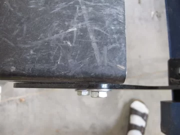

I/O (Brave Products) has since improved these cradle supports and they are now significantly heavier and "beefier" than the earlier version.
I'm listening but...... Pics or it didn't happen! Let's see it! I was just about to order a 33flame setup for it but now I gotta see yours.

MasterMech, your slightest wish is my command! Sometime this afternoon I will take a photo of the original and newest brackets side-by-side. The difference is significant. But, Uh-Oh, now I must learn to upload photos. This should be interesting. You might have to be very patient for the photos to arrive. ;em
OK, MasterMech, here is my first effort at uploading photos:
[Hearth.com] Splitter:  big logs AND SMALL - what's good for all?[Hearth.com] Splitter:  big logs AND SMALL - what's good for all?[Hearth.com] Splitter:  big logs AND SMALL - what's good for all?[Hearth.com] Splitter:  big logs AND SMALL - what's good for all? [Hearth.com] Splitter:  big logs AND SMALL - what's good for all?
jesus, what a disaster! I spent a long, confusing time learning the upload procedure and still do not know how the one photo arrived lower than the others. I'll sort it out one of these days - just takes time.
The various photos clearly show the difference in metal thickness between the older and newer log cradle brackets. Notice the triangular gusset on the new bracket (below) where it bolts to the "I" beam. ;em
View attachment 78845View attachment 78846View attachment 78848View attachment 78850 View attachment 78843
Very nice. I wonder if I can get them to send me a set or do I have to fork out the dough for 'em?
