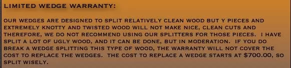

Entry level, non pto splitter, is $9,500 and the one in the video is $11,500. Would have to make firewood a second job to justify that expenditure. Maybe if/when I finally get a farm with a decent amount of wooded acreage. Really nice splitter though.
[Hearth.com] Splitter Recomendation - Huskee/Speeco
$9500 is a bit steep for a splitter that is picky about what you put through it. I think I like the multi-wedge designs that are powered by massive (5"+) cylinders and BFP's (Big "Fancy" Pump) much better than the box wedge.
