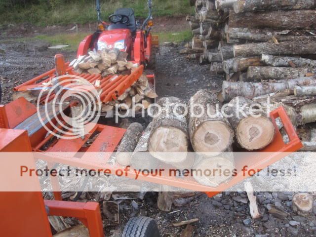

  • [Hearth.com] Splitter Recomendation - Huskee/Speeco
Yep, just watched a video on a 30 ton, green, home made splitter with log lift and hydraulic 4 way wedge. About to learn how to build a splitter. Took a year to figure out how to install the furnace myself so I could save several thousands of dollars on the install, so might as well learn all about hydraulics and welding now. Have always wanted to learn how to weld, so this is a really good excuse. Don't have an immediate need for a new splitter, so this might be a good project for after tax season now that the furnace and A/C have been installed. In the past year, I have learned more about car brake lines, car A/C, and residential HVAC than I ever thought I would. Might as well do the same for welding and hydraulics. That way, I can learn something and get the exact splitter that I want. It will be a fun project. Now I am excited.
We have seen what can be done!!
Of course we would want pics!!
Good luck!
See this post for inspiration!
https://www.hearth.com/talk/threads...-dirty-work-horses-you-call-a-splitter.93206/
