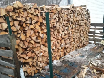

These four cords will be stacked in 4 rows, they're going to have to be pretty tall to fit a cord a piece, it will be easy to measure what I actually got though...
One down, three to go...[Hearth.com] Stacking Some Green

Anything over 4 ft. tall gets unstable and may tip over especially with freeze thaw cycles of the ground even if they are on pallets also strong winds and wood stacks also tend to lean toward the sun.

I was thinking that I would take some off, it doesn't feel stable enough. 6'6" would be a full cord, but that's too high. After taking a little off the top I'm going to stabilize this one with some pieces to the next one and maybe some rope or something very redneck like that.
Over time we found 4 1/2' to be about ideal. Very rare for a stack to fall over here.
