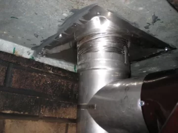

Regarding cleaning out the T - connector inside the fireplace behind your stove: The T - connectors come with a cap on the bottom of them a few inches below the horizontal pipe that connects to the flue collar on your stove. You attach the cap with a couple of sheet metal screws and then remove the cap when you clean your pipe. When I recently did my installation I positioned my end cap so that two of the three screw holes angled out at a 45 degree angle toward the front of my fireplace opening. I have about five inches on either side of my stove and my fireplace opening and I can reach the screws pretty easy by reaching in with a screw driver. I didn't put a screw in the hole in the back of the pipe since I wouldn't be able to reach it and two screws can hold the cap on securely. Some people remove the cap before they clean from above and attach a bag over the bottom of the T so all the creosote, ash, and soot go directly into the bag for easy cleanup. [Hearth.com] Stainless Steel liner questions
You can't see the cap in this photo, but it about three inches below the bottom of the picture.

Gotcha Nick, but my T would be inside of a masonry and clay flue with no access from the sides or below. You converted a fireplace so you can get underneath, the only way to access mine would be from inside the house through the thimble or from the chimney top.

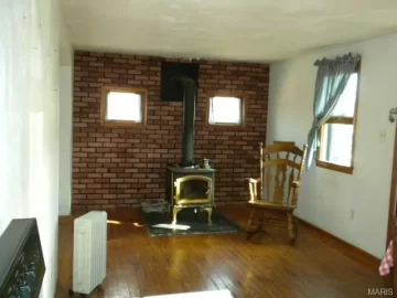

I'm with you now. I have a similar set up with my Woodstock Classic stove in the lower level of my house. When I clean my chimney for that stove I have to pull the pipe off the back of the stove and pull the other end out of the thimble. I take that three foot long pipe assembly outside to clean with a brush. Inside I use a cup to scoop out any creosote that fell through to the bottom of my T, which is actually just a continuation of the clay flue liner. It continues down inside the brickwork of the chimney (a huge 8' x 4' brick chimney) as far as I can reach my arm! I just scoop out down about a foot or so. Until recently I did not have any sort of cap on the flue at the top of the chimney and there would be leaves mixed in with the creosote, cinders, etc.

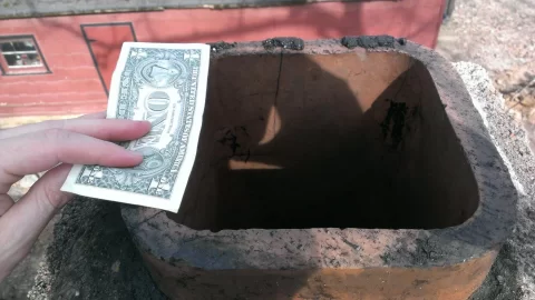

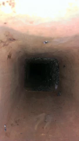

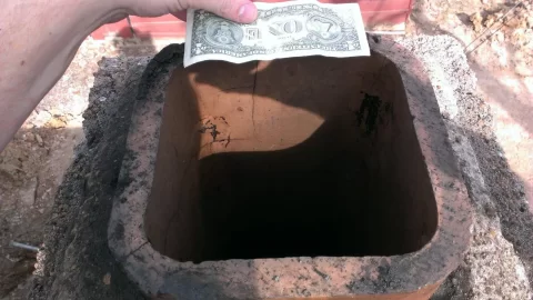

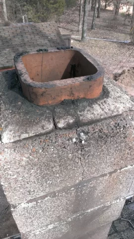

Finally got up on the roof the other weekend to take care of some other projects and wouldn't you know it I forgot my measuring tape. I happened to have a dollar in my wallet though, so here are some pics to estimate the ID of the clay flue. Best guess maybe 7" or just over?
That's gonna be tough to work with. Unless the mortar joints are perfect, it will be a struggle. Busting out the tiles will help.
Figure in two 90s, coupled with the already short flue, and I agree that going with a new class A would work the best. It just might not be aesthetically pleasing.
