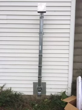

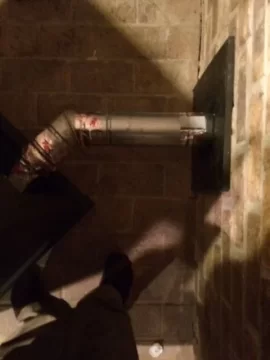

Looks ok from here,only possible thing could be a section is closed off with packing paper
mY WIFE JUST suggested that too. There is not as I check and I know air is blowing out as I went out and check airflow when we first fired up tests the other day. only 1 section had paper from shipping in it. but it is something i checked and airflow seems ok from the outside at the cap.

OK so you have nothing to lose.Lets see if it runs.Hook the wires together,OR tape off 1/2 the intake and run a test,see if there is a difference.Might actually need more tape than that but is a starting point for first test.If it does pass test,either way,put in pellets and see if it runs.If it does,good,will be time to borrow a gauge from a hvac person to see if switch/board or internal problem.

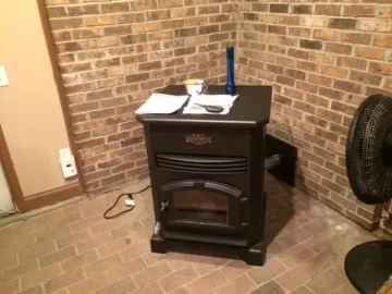

OK TRYING the initial dry run with the two draft sensor switch wires jumped. still pulsing but not getting light for draft fan. guessing has to do with wires jumpered. so she is still pulsing. looked again and not seeing any immediate leak area or potential leak areas in fire box. and still don't see a adjustment plate with wing nut for pellet release.
pulsing is normal.light not on means system is ok,adjustment plate in feeder unit is only on some models,would not affect your problem.Recommend leave jumpered,light stove,run for a while and see how it works,report results to MFG for recommendation.
