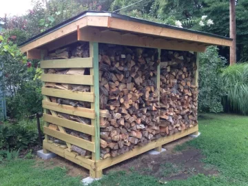

After all the years burning wood for heat this season has been full of new learning. Prior to this season I built a wood shed. What a difference burning dry wood compared to burning wood I thought was dry. My burn times were much longer and much hotter too. If I would have know the benefits of having dryer wood I would have taken out a loan to build this shed years ago. LOL Next year my wood will not only be dryer but seasoned properly also. I have wood split from last summer under a tarp and ready to move into the shed after this season.

Don't know anything about Jotul's but that's a nice wood shed. Dry wood is the key.

Nice shed, BTW...

Awesome shed, Rod. I am jealous! I feel like I have similar problems in my house, as you describe. I am going to tighten things up sometime between now and next winter, improve my block-off plate, and I bet most of the issues will go away. Good luck with your situation.

To the OP - sorry for being off-topic, your woodshed is gorgeous. Try to let your tarped wood air out a bit before putting it in the shed - I've had issues with the wood at the back of my shed not being dry enough.
