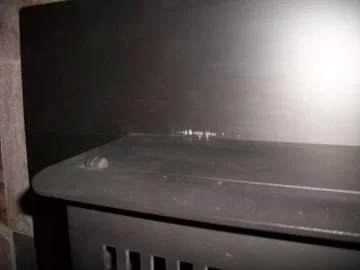

Any ideas on how I can remedy this. I have the paint just need to know the fix. Stove is out of level leaning to the front 1/8" and side to side is level. Would it be something as simple as that little bit of leveling?

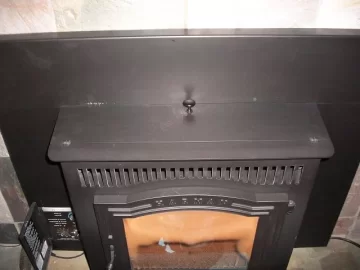

Can you post a piccy from a tad wider shot to show the entire stove/fireplace front ???
Maybe a hot looking down at the area of the scratches with the lid open as well please.

Shots requested, need others please let me know.

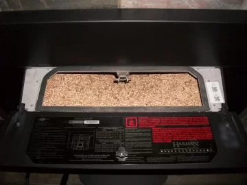

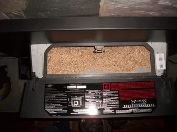

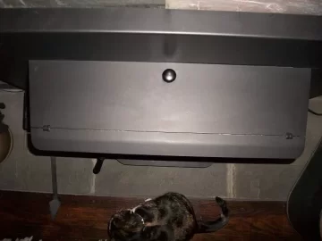

Hey John...Looking at the pictures and the way the lid opens, if it was me and it was my unit, I'd open the lid (like in 3 and 4) and take a Metabo (4 1/2" right angle grinder) and grind a bit off the left side (where the lid is scraping the back plate. That way you don't have to fiddle with anything level wise. A minute of grinding and checking the clearance and a sprits of paint and you'd be good to go.
