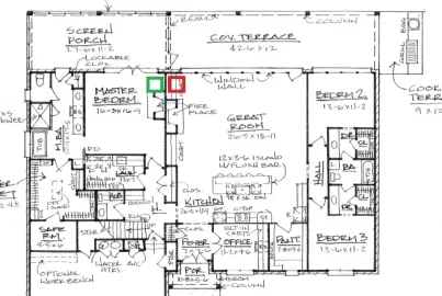

one stove or two? If you look at the attached image, you can see that the main living space is going to be a large and open space, almost 26x30 with what will likely be pretty tall selling. This space will get the primary stove in the location i identified using red. Second location that I would like to be able to keep warm is the master bedroom which I identified in green. I was going to put a smaller stove like the dwarf 4kw or 5kw.
Do I actually need the second stove in the bedroom or will the primary stove keep both of those rooms warm doing a full burn? Would it be better to do two stoves small in the bedroom and not as big in the main living space?

First off by code you cannot have a woodstove in a bedroom so that is out
