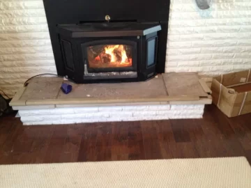

Recently installed a refurbished earthstove wood burning insert with catalytic converter and blowers to our masonry fireplace. It had previously had a gas insert so we had a 6" chimney liner in Great condition that we used.
First week of burning went well raising temp in house approximately 10 degrees but outside temp was in the 30-40s. However this was not a well seasoned wood, but it was ash but had not been felled for 6 months.
Fast forward a couple of weeks and we have had temps in single digits. We now have well seasoned wood but are having issues getting sufficient heat. Wood seems to last about 3-4 hours at best completely full but it never seems to raise temperature of house although the blowers are blowing out hot air it doesn't seem as much as before and is not raising temp of house more than a degree sometimes and that is after a couple Of hours.
Any tips? Is it likely just because of too cold of temps ? Manual on stove says should burn 9-10 hours and heat approx 1500 sq ft

How did you get "well seasoned wood" In a few weeks. Did you get a different supply that you checked the moisture content on or are you assuming that with a few more weeks on it your original supply is seasoned better. The wood you were burning a few weeks ago is the same now as it was then. You were getting enough heat out of it in milder temps to heat your house but enough for the more severe weather. Sounds like a classic case of wood that's not dry enough. We've all been there.
Others may think of something else but I'm guessing the wood Is the culprit and you are boiling water.
More details would help, like your floor plan and stove location, model of your stove and the size of the firebox, and also how well your house is insulated. Everyone will question your wood also--have you used a moisture meter on the new face of a fresh split? Also, what do you mean by the wood "lasting" 3 or 4 hours? The manual's burn time probably includes the long coaling stage, which often doesn't throw off enough heat when it gets really cold. Lots of threads on here lately about what to do with your coals so you can start another fire.

We got a different supply of wood :) I have not done a moisture test where do I get one of those ? This wood we are burning now has been felled over a year and visibly "looks" much dryer than what we were burning that was actually producing more heat which makes me think we have another issue ?
Stove is a newly refurbished Earthstone BV400c-2 wth a catalytic converter as blowers. Located in family room that is long and narrow with an open concept to the rest of the downstairs. House is otherwise insulated fairly well. Firebox is 3.72 cubic feet
I have one I bought on Amazon. The brand is "General" and works great. Lots of threads here on moisture meters and it is the only real way to tell what you are dealing with. Split a piece in half and measure the inside. Anything over 20% moisture content is going to give you an unpleasant burning experience as it seems you are having.

I have got a moisture meter now and I think the problem with the wood is what I grabbed from the stack he brought is what was stacked on the bottom and it was not on a skid. So some of it drewmoisture in. Other pieces are very dry. Which also explains why it was fine for a while an just bad the last couple of days.
However I still don't feel like it is warming it quite as I thought it would although today it is approx 30 out and it raised it to about 70 with no furnace help. Imagine my house as a square with an enclosed staircase going right up the middle of the house. Other than where the stairs are the house is open concept with normal ceilings not high at all. The stove insert is located in the northeast corner of the house. No creased light fixtures. Downstairs is approximately 1200 sq ft. No attic access in house.

Do you have a block-off plate? https://www.hearth.com/talk/wiki/make-a-damper-sealing-block-off-plate/
Sounds like the fireplace is at an exterior wall. Would there be room to put some insulation around it? https://www.hearth.com/talk/threads/finally-got-around-to-insulating-my-fireplace.75755/
You can check with an IR thermometer the back of the fireplace outside. You will probably be surprised how much warmer that is compared with the wall a few feet away.
P.S. I think that stove needs 18" of hearth measured in a straight line from the door. The picture may be deceiving but it looks like you don't have that.
