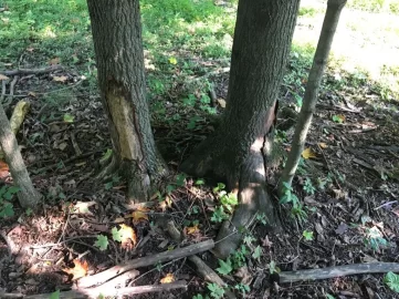

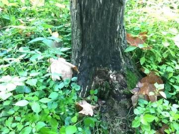

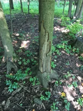

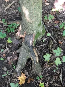

This stand of sugar maples is dying off. Can you think of a reason or cause? Not sure if we should just cut it all and burn in place or if it could be moved for firewood. Also hoping there is a way to treat it?

Your cattle may be grazing on the bark. Or hoof damage from cattle sheltering under the trees.
Cattle rubbing and grazing on trees, Hoof damage and soil compaction, would all be factors in my book...
If the damage starts in the leaves I would suspect verticilium wilt but if it starts at the base I would think more along the lines of physical damage to the base.
I had several cedars damaged at the base during a logging operation and most of them died.
So far it seems physical damage is the most likely. I've never seen the cows do this before but I will keep an eye on it.
Put me into the physical damage column. If cattle are roaming around soil compaction and maybe urine within the drip zone isn't helping.
I ran a skidsteer and mini-excavator around my property and nicked some trees with the equipment. Almost every one of them, opened up and you can now see 'wounds' like the one you are describing.
