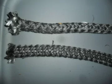

Ok, Happen to have some 1" round and 7/8" flat. The flat is dense graphite coated. The 1" has a core of rope gasket wrapped with yet another rope gasket casing around the core. Both 1" and 7/8" graphite coated.
Pics show side by side from 2 angles. Then next to each other, if you look hard enough, you can see how the 1" behind the 7/8" stands higher.
The 7/8" is 7/8" from side to side on the flat side. I didn't measure, but it is about 5/8" or so thick flat top to flat bottom.
Trust me, I changed the gasket 4x. Anything smaller than the 7/8" flat ain't going to seal, and the 7/8" flat don't seal that great to start with. When I used the 1" it sealed perfect. And had to adjust the latch catch out a bit.
Don't want to stress the latch too much with too tight a door, as it will wear the cast door or the washers on each side of the latch. The only reason I went back to 7/8" was I replaced the glass, and wanted to give the 7/8" a shot again. Still not as tight as I want on the lower latch side corner. I will be going back to 1" whenever I need to change the gasket again. The softer gaskets even 3/4" will not seal good. Been there tried that.

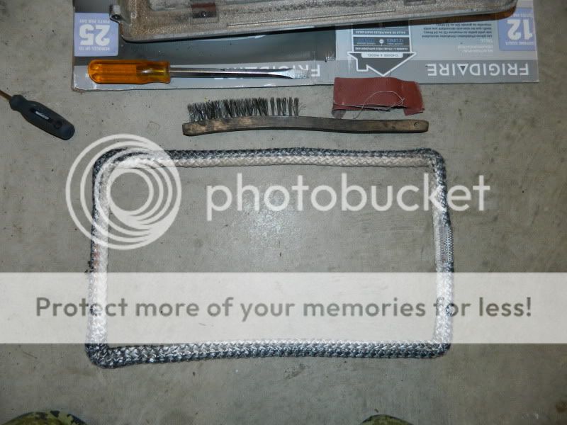

Pic of the gasket and tools used (Large screw driver, wire brush and some emery cloth). This is the side of the gasket that is touching the stove, hard to see but their is a prominent grove here, I plan to flip this around and have this side touching the door.
[Hearth.com] Summit door gasket? Updated with pics.
