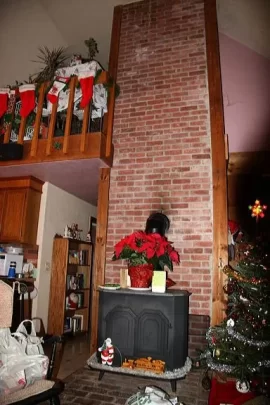

The brick in my hearth comes from a burned down mill that was destroyed by a huge fire. I loaded the bricks into my pick-up to get them to my house under construction, and then played apprentice to a mason to put the chimney and hearth up. I chipped the mortar off and cleaned each brick by hand.
[Hearth.com] T5 performance update
Cool story OH! Nice chimney too!
