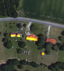

Picture of my roof from Project Sunroof showing how good it is. My neighbor has taken down those big trees next to me so I have even more sun on that side.

You do appear to have an ideal roof for solar but the first question most solar folks would have is why so big?. Have you done the up front efficiency work to minimize the system size? Most home systems are less than 10 KW.
I could go down to a 10-13kw for sure. Let me ask you @peakbagger what asphalt shingles are you seeing put down these days that does well under a panel if I went that route?
